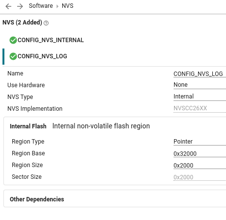

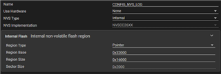

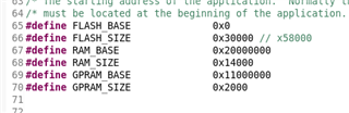

I want to use flash memory from 0x0 until 0x2FFFF for my program, 0x30000 until 0x31FFF for time value, 0x32000 until 0x57FFF for log value.

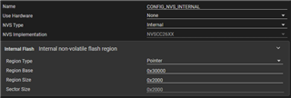

i already set the NVS:
but i got error while change linker command file (ccc13x2_cc26x2_tirtos7.cmd) for change the flash size from 0x58000 to 0x30000.
my program suddenly error in half of program running, then can't be reboot again. but the program can run normally while i used 0x58000 flash size.

    • open file cc13x2_cc26x2_tirtos7.cmd, change #define FLASH_SIZE              0x58000 to #define FLASH_SIZE              0x30000

    I configured the memory in sysconfig as shown by you and also changed the flash size define.
    When I start the serial terminals I can use the programs functionality without experiencing any issues.
    Can you please start with a fresh project and only change the flash sections using sysconfig?
    Another note to changing the flash size: When you define different flash sections in sysconfig you don't need to change the flash size define as it is overwritten by the changes you make in sysconfig.

    2. I defined the two nvs sections as follows:
    And I also changed the .cmd file define.
    Please load again the unmodified example from the sdk, only perform the described changes and let me know if it works.

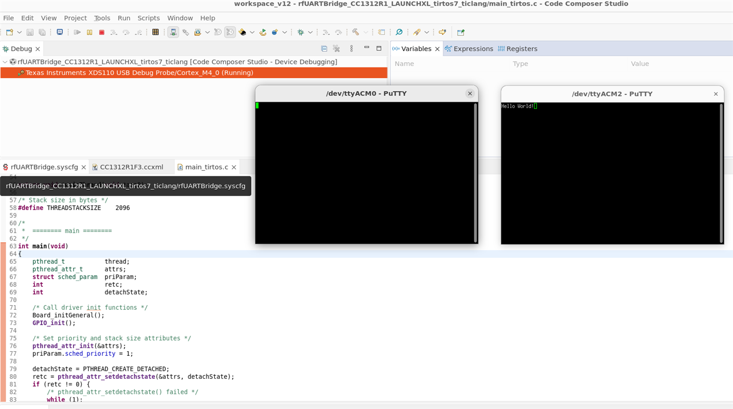

  • there only run once time, i don't received any response while click reset button (beside micro usb port), usually the program will restart when i press that button
  • Hi Muhammad,
    if you press the reset button while you have an open debug session you will end the session so everything is not connected anymore.
    Instead you need to use the microcontroller icon on the top bar next to "run" to reset the device without interrupting the debug session.
    Kind regards,
    Theo

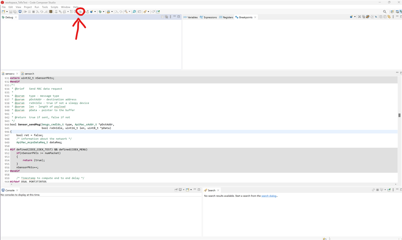

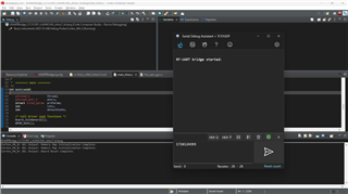

  • i also did in another case as well, serial monitor only. but the program only run in the first program running, while i do board reset the program is not running as expected. i tried also in example empty project.
  • Hi Muhammad,
    you must use the option "reset board" in the debug window of CCS to keep the debug session running. Please see the screenshot below:
    Otherwise you need to use an external terminal emulator like Tera Term: https://teratermproject.github.io/index-en.html
    Kind regards,
    Theo

    • cc13x2_cc26x2_tirtos7.cmd file, change #define FLASH_SIZE              0x58000 to #define FLASH_SIZE              0x30000.
    • Flash into board, after flash completed the program run normally. then click reset button, the program not run normally (can't blink).

  • Hi Juan,
    please do not change the linker .cmd file.
    Instead change the flash as described in my previous post (quoted below) in sysconfig.
    Kind regards,
    Theo

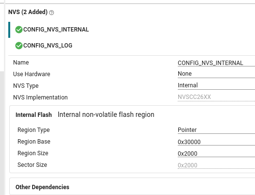

  • Hi Theo,
    if i only do this and don't change the linker .cmd file, the program run normally. is it enough to manage the flash memory?
    Juan
  • Hi Juan,
    yes it is.
    Kind regards,
    Theo
