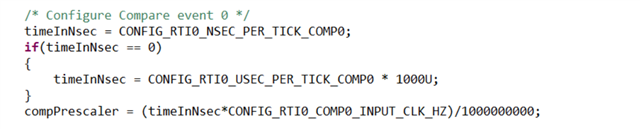

  • while generate the code from sysconfig timer's interrupt time fixed as user defined time
    In run time timer's time need to change from 100us to 90us. Timer configuration settings are in TI_driver_open_close.c file
    and this file is not changeable by user.
    So please let me know how to change timer's time in run time.
    The TI_driver_open_close.c file is generated by SysConfig, which is why you cannot edit it.
    You can reconfigure the compare event by copying the code block above into your main code and replacing
    CONFIG_RTI0_NSEC_PER_TICK_COMP0 with 90000u
    and
    CONFIG_RTI0_USEC_PER_TICK_COMP0 with 90u
    This should allow you to change the interrupt time.

    CONFIG_RTI0_NSEC_PER_TICK_COMP0 is a defined value, so you cannot change it in your code. You would have to use a new variable instead.
    I will try and provide an example on Monday.
    Thank you,
    Susan
    I realized while working on this I may have made it more complicated than it needs to be.
    To make sure I understand correctly, you are using one interrupt for 100us for a duration, then needing to change that interrupt to 90us after that?
    If that is correct, then an easier way to do this is to set up 2 separate compare events in SysConfig, one at 100us and one at 90us, then disabling the one you do not need until you switch.
    Disabling Compare1 (Interrupt 2):
    (void)RTI_intDisable(CONFIG_RTI0_BASE_ADDR, RTI_TMR_INT_INT1_FLAG);
    Disabling Compare0 (Interrupt 1) and Enabling Compare1 (Interrupt2):
    (void)RTI_intDisable(CONFIG_RTI0_BASE_ADDR, RTI_TMR_INT_INT0_FLAG);
    (void)RTI_intEnable(CONFIG_RTI0_BASE_ADDR, RTI_TMR_INT_INT1_FLAG);
