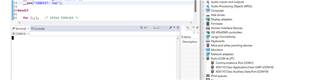

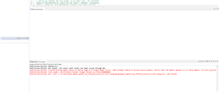

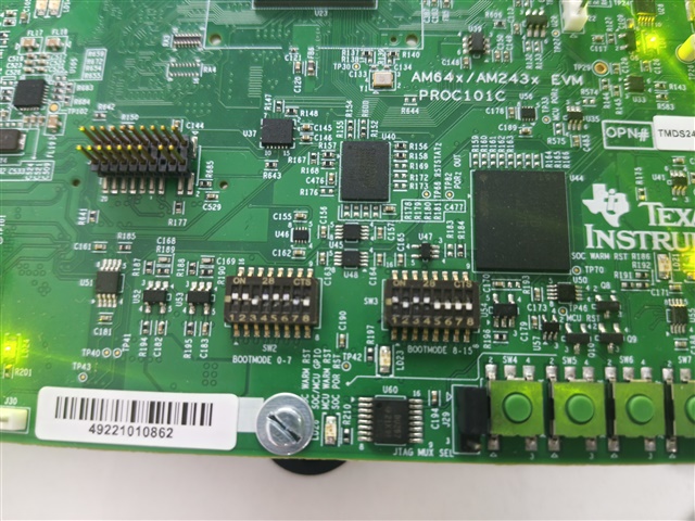

To check the process for device type you have mentioned, we are not getting any response in terminal. also attached images regarding Boot mode selection for your reference.

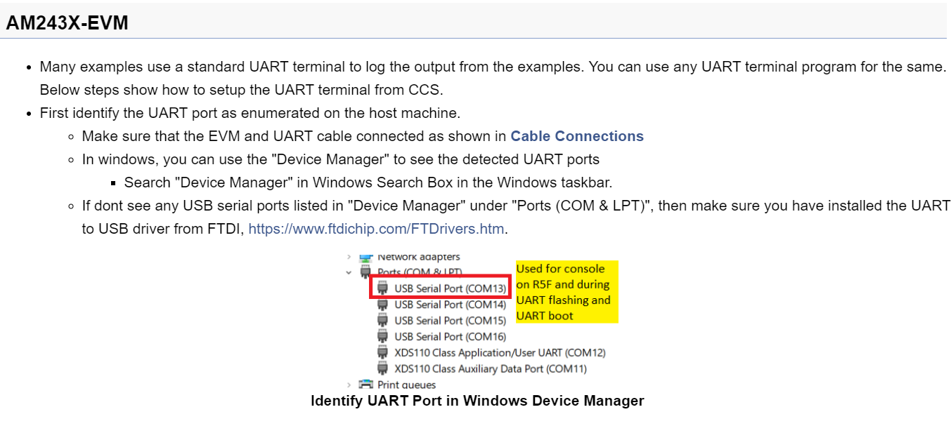

If we check the MCU SDK Doc, we see that there are 4 ports which show up as follows:
Now, I think you have not yet installed the drivers. I would recommend you to go ahead and install from the following web link: https://ftdichip.com/drivers/
Post this you should be able to see the ports and apart from that, you should be able to open that port on CCS window as well.
