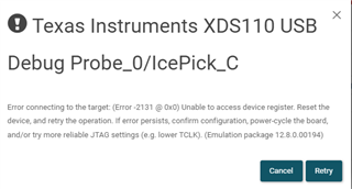

Would like to program my CC2652PSIP device with lower TCLK rate, about 1MHz. With CCS it works correctly, I can debug my application. UniFlash ignores the 1MHz setting, it uses 5.5MHz and I get error -2131 @ 0x0. Any hint?

  • Thank you. We are investigating.
  • Are you using the LP-CC2652RSIP or is this a custom board with an external standalone XDS110?
  • I'm using a custom board with external standalone XDS110.
  • Konrad,
    I think you might be running into a bug in the UniFlash GUI code.
    Can you try copying the ccxml you are using to the following location (<installDir>\deskdb\content\TICloudAgent\win\ccs_base\arm\) and replacing the cc13xx_cc26xx_2pin_cJTAG_XDS110.ccxml file there (back up the current file if you want)?
    And then try to connect to your board in UniFlash GUI again.
    Please let me know if this works.
    Alternately, please try using the UniFlash CLI instead. This should bypass the ccxml bug.
