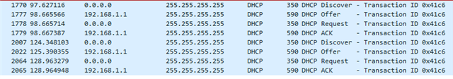

  • This is the part of the project where I found WireShark very useful.
  • That's a good idea, using wireshark.  I went ahead and compared the two boards, and I got the following for the launchpad:
    But for the custom board, I found nothing whatsoever.  I already disconnected the POE diode bridges and I think I'll take a look at the voltages on a scope next, to see if there's any voltage come off the pins.
