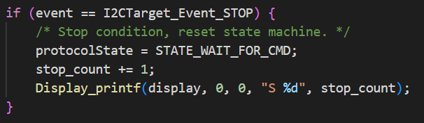

On the target side, the event I2CTarget_Event_STOP doesn't seem to trigger, verified using print statements.
Does the example never enter the I2CTarget_Event_STOP state, or are there specific conditions that need to be met? Thanks.

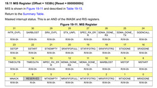

  • Hi Eason,
    I have debugged it. The reason is due to the underlying code of the software. Here we will read the MIS of I2C register and multiply with 0xFFFF. If the stop bit is detected, it will enter if function you attached.
    But according to User guide, the stop bit status lies in the former 16bit, so it should multiply with 0xFFFF0000 not 0xFFFF.
    I will report this issue with our software team, thanks for pointing out.
