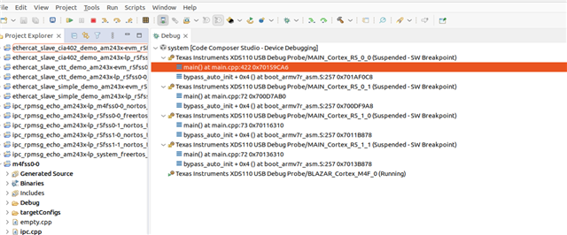

Sometimes when I try to Debug all cores together, all r5 cores are naturally suspended waiting for me to click the "Resume" button. But strangely I see that the M4F core is already in the "Running" state. When this happens, my applications do not work properly.  I am sharing the image showing my core states before clicking "Resume" after pressing the Debug button. You will see while all cores are suspended M4f is already running.
Can you please help on how to fix it?
Kadir

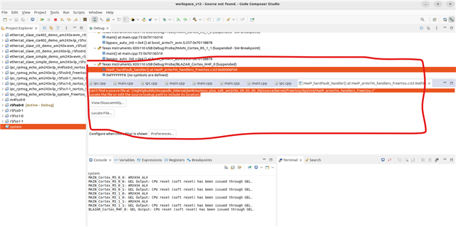

  • Hi Tushar;
    *When you say M4F core is running, Is it after loading the program to M4F the core is not halting at main() function?
    Yes you are right.  It is after loading the program to M4F the core is not halting at main() function.
    *Before loading program to M4F core, Are you doing a CPU reset?
    No, I am not doing CPU reset. Should I? When I use "Reset" button before debug on the launchpad, this abnormal state does not occurs.
    *Can you halt the M4F core and see which code it is trying to execute during the abnormal state?
    I can not see to the resource -> HwIp_hardFault_handler() at HwiP_armv7m_handlers_freertos.c:63 0x00006F04
  • Hi Kadir,
    Yes, it's always recommended to do CPU reset before loading program to a core.
    After resetting the CPU, are you able to load the program successfully?
    You should not do a System Reset. It will do a warm SoC reset and all the cores will be in WFI mode.
    You should only do CPU reset for a specific core on which the program is supposed to be loaded.
    The CPU might be in invalid state when you try to load program without resetting the core and it is going to fault handler.

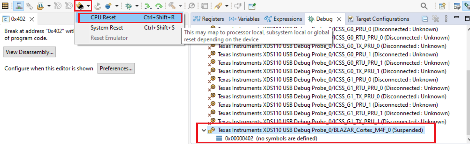

  • Hi Kadir,
    I am just wondering  how to do CPU reset. Could you give brief information about that?
    Select the core from the target configuration file which you want to reset. Click on the reset icon and click on CPU reset option.
    Please refer below image for detail.

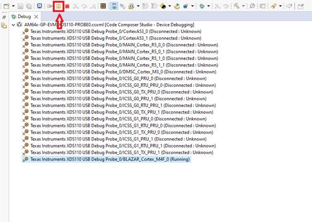

  • Hi Tushar,
    Thank you so much!
    It seems like CPU reset is possible when the core is suspended. When it comes to my problem, beginning of debug it does not stop on main this means it starts in "Running" mode not "Suspended"
    Is it possible to CPU reset while the core is in "Running" State? Depending on the system reset fixes my problem, do you think CPU reset fixes my problem too??
    Kadir
  • Hello Kadir,
    You can halt the CPU before doing a CPU reset. Please refer below image.
