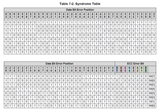

  • Hi Hanson,
    If a single-bit error occurs in the ECC code itself (as opposed to the data), how does the SECDED mechanism handle this in terms of both error detection and correction?
    SECDED module can be able to detect single bit errors in the ECC code as well.
    Please verify below highlighted data in the syndrome table:
    For example, if ECC bit-4 gets corrupted then the generated syndrome will become the 0b00010000, so based on this it can detect the single bit error in ECC 4th bit and can do the bit correction.
    From a correction standpoint, is there a risk that the mechanism might incorrectly correct the data based on a faulty ECC code, while leaving the ECC code unchanged? This is a major concern in my application
    No, there won't be any risk in the corretion mechanism.

  • Hi Jagadish,
    Thank you for your response.
    I would like to confirm my understanding regarding single-bit errors in the ECC code.
    You mentioned that if a single-bit error occurs in ECC bit-4, the syndrome would be 0b00010000. I understand that the syndrome is generated during the ECC verification process when comparing the received ECC code with the recalculated one. For example, if data bit 26 has a single-bit error, the syndrome generated would be 0b11100110, allowing the system to detect and correct this error.
    Could you please confirm if my understanding is correct?
    Hanson

  • Hi Hanson,
    You are correct, here the syndrome is nothing but XOR of regenerated ECC and old ECC.
    You are totally correct.

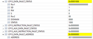

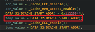

  • Hi Jagadish,
    Thanks for your reply - it was very helpful !
    However there is still something greatly confusing me.
    I've checked the thread and  attempted to generate an ECC error .
    Here is my procedure.
    When the program reaches the code in the red box, a data abort is triggered.
    The 0x300000000 is the start address of Dcache ,which is also the address I tried to read from.
    The data fault status provides the following information:
    Based on this,I believe either the cache is not properly prepared ,or the way I am accessing it is incorrect.

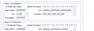

  • Hi Hanson,
    Apologies for the delay in late response, i was stuck with lot of other issues in this mean time.
    Regarding this issue i am suspecting one thing:
    If we try to directly access the any area that is not configured in MPU regions then we can't access them and it can produce abort exceptions, please very the below default configurations.
    So, my suggestion would be trying to configure this area also into one of the regions like below:
    This might solve this issue, please check and let me know.
    Thanks & regards,
    Jagadish.
  • Hi Jagadish,
    Apologies for the late reply. I just finished my holiday.
    Thank you for your advice. I tried configuring the MPU as you suggested, but unfortunately, it didn’t resolve the issue. I’m still encountering the same problem as before.
    I actually don't think the data abort is triggered by the MPU.As we can see, writing 0x11223344U into the cache memory didn't trigger a data abort while reading from the same address did.
    The data abort status indicates it's a Synchronous External Abort whereas the MPU would trigger background abort if we access the undefined area.
    Thanks again for your advice. I initially overlooked the MPU when accessing the cache as regular memory. But it seems that this might not be the cause of the issue.
    Any further suggestions would be greatly appreciated.
    Thanks & regards,
    Hanson.
  • Hi Hanson,
    Is it possible to share a sample code with the above issue, so that i can quickly do a debug on my end.
    Thanks & regards,
    Jagadish.
  • Hi Jagadish,
    I've prepared a simple demo for you.
    Please check it.
    Thanks & regards,
    Hanson.

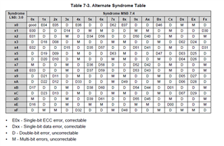

  • Hi Hanson,
    Sincere apologies for the further delayed response, make sure to respond without delay next time.
    It appears that even though the actual data in flash memory remains correct, we still can’t retrieve it accurately if there’s a 3-bit ECC error within the ECC code itself.
    In other words, if I attempt to read from a flash region where an ECC error exceeds the SECDED (Single Error Correction, Double Error Detection) capability—despite the data itself being intact—the returned value will differ from what’s stored in flash.
    I never tested this practically but this as per my knowledge this should not happen. If there is a multibit (more than 2 bit) error in ECC then the returned data should not be wrong.
    As per the syndrome table this 3-bit error in ECC will give multi-bit error. For example, assume least 3 bits in the ECC were got corrupted:
    Example:
    ECC before corrupted: 0x46
    ECC after corrupted: 0x41
    Now syndrome (Syndrome is EX-OR of ECC before corrupted and ECC after data/ECC corrupted) will become: 0x07
    So, if you compare this 0x07 with syndrome table it will point to the first column 8th element, right? which is nothing but M in this case, here M means multi-bit error. So, any multibit error in the device will trigger the uncorrectable ESM flag similar to the double bit error and it might also generate exception.
    Thanks & regards,
    Jagadish.
