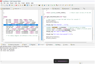

  • Hi QJ Wang,
    Thank You for your replay so, i tried your logic in GPIO LED code i just replaced your logic i attached the code below.
    what are ever we flash it will load into the RAM memory so i consider  OCRAM : ORIGIN = 0x70040000 , LENGTH = 0x40000 this one
    #include <drivers/gpio.h>
    #include <kernel/dpl/AddrTranslateP.h>
    #include <kernel/dpl/DebugP.h>
    #include <kernel/dpl/ClockP.h>
    #include "ti_drivers_config.h"
    #include "ti_drivers_open_close.h"
    #include "ti_board_open_close.h"
    #include <sdl/sdl_mcrc.h>
    #include <stdint.h>
    #define MCRC_CTRL0   (*(volatile uint32_t *)0x35000000U)
    #define MCRC_CTRL2   (*(volatile uint32_t *)0x35000010U)
    #define MCRC_STATUS      (*(volatile uint32_t *)0x35000028U)
    #define MCRC_SIGREGL1  (*(volatile uint32_t *)0x35000060U)
    #define MCRC_SIGREGH1 (*(volatile uint32_t *)0x35000064U)
    #define MCRC_SIGREG     (*(volatile uint64_t *)0x35000060U)
    /* Function to calculate CRC */
    uint32_t crc_calculate(uint64_t startAddr, uint32_t count)
        volatile uint32_t index = 0u;
        MCRC_CTRL0 |= 0x00000001U;          /* Reset the CRC Module */
        MCRC_CTRL0 &= 0xFFFFFFFEU;
        MCRC_CTRL2 |= 0x00000003U;          /* Configure to Full CPU Mode */
        for (index = 0u; index < count; index++)
            MCRC_SIGREG = *(volatile uint64_t *)startAddr;
            startAddr += sizeof(uint64_t);  // Increment by the size of uint64_t
        return (uint32_t)(MCRC_SIGREG);      // Return lower 32 bits of the CRC
    void gpio_led_blink_main(void *args)
        /* Open drivers to open the UART driver for console */
        Drivers_open();
        Board_driversOpen();
        DebugP_log("Test Started ...\r\n");
        uint64_t startAddr = 0x70040000;  // Starting address in OCRAM
        uint32_t count = 0x40000 / sizeof(uint64_t);  // Number of 64-bit words to read
        uint32_t CRC = crc_calculate(startAddr, count);
        DebugP_log("CRC value is %0XX\r\n", CRC);
        DebugP_log("All tests have passed!!\r\n");
        Board_driversClose();
        Drivers_close();
    I got the value can you just verify this logic if is ok?
    Below is my output.
    Here, i have the doupt i need a tool or external software or inbuild software to do CRC32 calculation....and in that tool i need to test my Flash Address or Ram address in the run time and i need to check the both the implementation is right or wrong?
    kindly provide the solution, Thank you.
