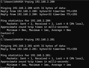

i am Working on AM2634 and i am trying to ping the 2 ip's in No-RTOS project
i could able to ping the both the ip's on free-rtos i attached below. But my requirement i need to work on only no-rtos.
i created the app.main in the below

so here i declared both the ips
const ip_addr_t gStaticIP[IP_ADDR_POOL_COUNT] = { IPADDR4_INIT_BYTES(192, 168, 2, 200) /* For NetifIdx = 0 */, IPADDR4_INIT_BYTES( 192, 168, 2, 201) /* For NetifIdx = 1 */};
but i couldn't able to ping the IP so what i need to check and can you provide me the way to figure it out my issuess?
