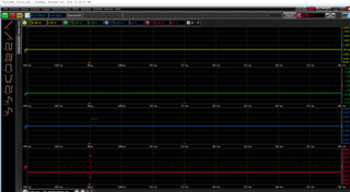

I am having trouble figuring out why there is a long uart delay between receiving a packet of data and transmitting a packet of data.
The delay between receiving a packet and transmitting a packet is about 25ms.
Below is the code that is running in main.c.

I am using a third party library called FreeModbus to handle the communication.
Before you say IT doesn't support third party libraries, I am looking for some general guidance on how to profile or determine where my application it is taking so long to run.
I have found some guidance here,
This does work but does not give me enough information.
I have tried going to Tools->Profile->Setup Profile Data Collection to collect profile data, but this doesn't work.
The Active On textbox stays blank.
I have tried stepping through the program, however it also doesn't work. When I attempt to step through portserial.c I get dumped into exit.c,

      I suppose you use xMBPortSerialGetByte to receive UART data and xMBPortSerialGetByte to send UART data. Is that a correct understanding? Why don't you do as follows for diagnosis of the delay?
      1. Set a GPIO pin high at the end of prvvUARTTxReadyISR and then clear the pin at the end of xMBPortSerialGetByte. This will measure the time a receive UART ISR is entered until the the UART char is actually read out. I want to know how much time your protocol stack is involved in this process.
      2. Set a GPIO pin high at the end of prvvUARTTxReadyISR and then clear the pin at the end of xMBPortSerialPutByte. This will measure the time a transmit UART ISR is entered until the the UART char is transmitted.
      3. Set a GPIO pin high at the end of xMBPortSerialGetByte and then clear the pin at the end of xMBPortSerialPutByte. I want to know how much time your protocol stack spend between receiving a UART char and sending a UART char.
     You can use the GPIO at places as you see fit to narrow down places where the delay is taking place. The delay may be in your protocol stack that is not shown in your snippet of code.
      I have not heard back from you. I will close this thread for now. If you have any update you can write back to this post and the status will automatically change to OPEN.

    The results are pretty confusing.
    Channel 1 is GPIO Pin PF4, Channel 2 is Pin PE2, Channel 3 is Pin PE0, Channel 4 is the UART Bus.
    Allan
  • Based on your waveforms this is what I interpret:
    Sorry for the late reply, but we were devastated by hurricane Helene. No power, water, or internet for a week.
    Hope everything is well with you now. We also had Beryl hitting Texas this past summer. We were without power for many days with 100F temperature.
    PE2 stays high for a very long time once prvvUARTTxReadyISR is entered until it is cleared in  xMBPortSerialPutByte. This tells me that UART TX is empty for you to write data to its TXFIFO but you haven't received anything on the RX and therefore didn't write anything to the TXFIFO yet.
    PE0: The time from xMBPortSerialGetByte to xMBPortSerialPutByte is also very long. You did not capture enough waveform when PE0 is first set. All I can see is that PE0 stays high for a long time. This means it has read something from the RXFIFO but didn't write to the TXFIFO yet.
    PF4: You are measuring time from when prvvUARTTxReadyISR is entered until xMBPortSerialGetByte is called. This pulse is quite short. This tells me as soon as TXFIFO is empty then it will quickly send out the characters. By the time the next char is received, PF4 is cleared.
    From what I see, I have a question. Why do you want to wait for TXFIFO to be empty before transmitting out chars?  Why don't you transmit out chars as soon as you are done reading chars? In another word, why don't you call xMBPortSerialPutByte as soon as you are done with xMBPortSerialGetByte instead of waiting for TXFIFO to be empty.

    I did some more debugging and I think I have narrowed down the problem.
    I set pin PE0 to toggle by modifying the prvvTIMERExpiredISR() function in porttimer.c,

    Toggling this pin produces a delay about the same amount of time between RX and TX.
    I tried reducing the delay by modifying the timer configuration, but reducing the delay too much prevents the MCU from transmitting anything at all.
    When the delay is too short you get four PE0 pulses and no TX.
    Channel setup is still the same.
    Changing vMBPortTimersEnable() in porttimer.c to try and force it to TX now prevents the MCU from transmitting,

    You get the same four PE0 pulses and no data back from the MCU.
