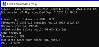

I have recently used J-flash lite software along with a Jlink Base debug probe in order to flash my MCU "MSPM0G3107".
In order to test the probe I quickly created an empty project on Code Composer Studio and flashed the hex file onto the microcontroller. The program download was successful as was indicated on J-Flash Lite but the problem is that I have not been able to flash the MCU anymore and the probe couldn't establish connection with the target anymore. I suspect that the issue originates in the empty project code example which consists of an infinite loop. I tried some troubleshoot fixes proposed on Segger wiki page : https://wiki.segger.com/J-Link_cannot_connect_to_the_CPU but nothing seems to work out.
Does anyone have any relevant solution to this problem?
Thank you.

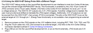

  • Hello Luke,
    Thank you for the support. I have solved the problem by using UniFlash to  perform a factory reset. I connected to the MCU through the MSPM0G3507 Launchpad since I couldn't do it with the Jlink debug probe.
    Regards.
