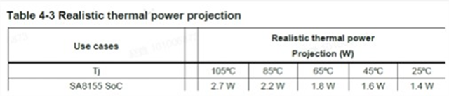

Customer would like to estimate the power consumption of AM2732 under different temperatures,
can we provide the typical power consumption table similar to below snapshot?

Hi Experts,
Ken
