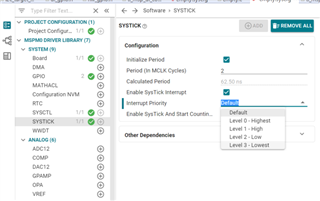

What is SYSTICK default interrupt priority?
How to change the interrupt priority of SYSTICK?

You can open one example code from our SDK and open the Sysconfig. You can find the Systick module and find the setting of Systick interrupt. You can set the interrupt priority in the sysconfig.
About the details of Systick and interrupt priority, you can refer to the chapter "Setting Interrupt Priority" and chapter "3.4.2 System Tick Timer (SysTick)" in the TRM.
