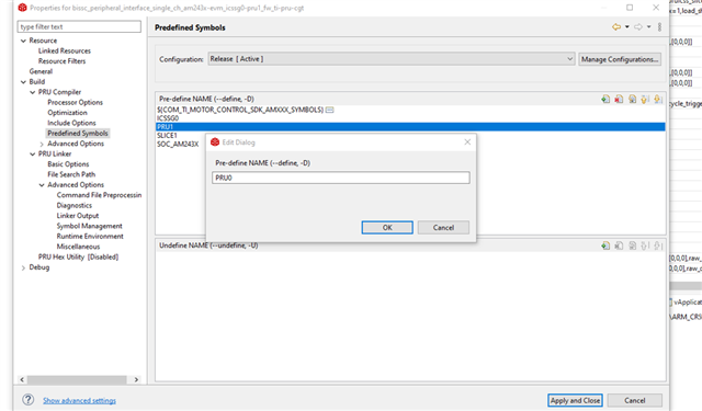

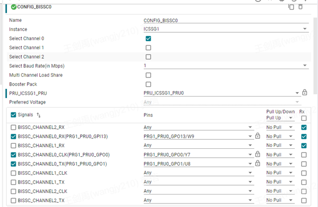

I am working on AM2431 ALV and trying to implement BissC encoder based on motro control sdk v9.2.0.09, with example bissc_diagnostic_signle_channel_am243x-lp.
A big difference is that pins is changed to PRG1_PRU0 for our board.
I tested the code on AM2431 ALV. The code is unchanged.
In function bissc_pruicss_load_run_fw, when program has finished function PRUICSS_enableCore,
-  for LP_AM243, PRG0_PRU1_GPO0 starts to output 1Mhz clk signal, originally high.
-  for AM2431 ALV, PRG1_PRU0_GPO0 changes to low from high.
My question is whether I need some more modifications. Is BiSSFirmware_0 only works in PRG0_PRU1?
