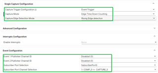

You can use Event module to use COMP to trigger Timer generate capture event.
You need to first send the COMP signal to event module, like channel 1.
The use Timer capture to catch the signal and use this signal as the capture trigger:

Maybe your timer duty is too fast.
Can you check the resistor setting at here, to see if the COMP event is generated:
