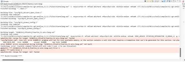

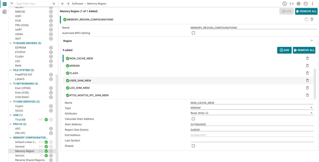

1:Hello, I would like to consult a question. My project is very large, but the chip's memory is not enough. How can I allocate memory? What is the maximum amount of memory? Please take a look at my memory allocation in sysconfig.
2:My chip is the AM2434ALV. How can I run the code in DDR4 memory if I use a DDR4 chip?
