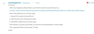

  • Hi Jimmy,
       After issue happend, please help to use the link script to dump the log to us.
       /cfs-file/__key/communityserver-discussions-components-files/908/am243_5F00_rom_5F00_dump_5F00_data.js
       Here is the steps how to use this script,
       1  Using CCS connect Cortex_R5_0_0
       2  Open the the View->Scripting Console
       3  loadJSFile <path>j7es_r5_dump_log.js
       Then am64x_r5_log.bin and am64x_r5_trace.bin will be generated in /temp folder.
       Then upload the files to this thread. Thnaks.
    Linjun

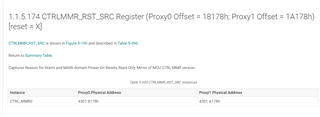

    When you face the issue, can you check the value of CTRLMMR_RST_SRC Register ?

  • Attaching the register snapshot from the TRM being referenced here:
