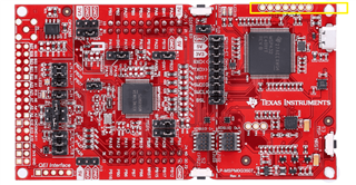

I can't run the demo from the sdk.
and if i run the code, the connection of xds110 will break. What should I do?

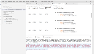

I also try from code composer studio theia, it is the same wrong.

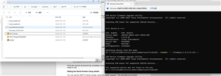

I think the XDS110 code update is failed. You need to update it manually. The bin code is at here:
I mean you need to use another XDS110 to update this LP with Uniflash manually from here. I think you can't use USB to update the LP.
