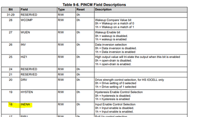

2.Customer use the PA15 pin by dynamically switching between output-H, output-L, and OpenDrain.
When OpenDrain is used, a voltage of about 1V is applied to the pin.
Is there a problem? They think it would be good if the input was disabled with INENA of IOMUX below in OpenDrain settings but they could not confirm it.
