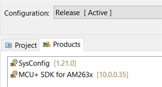

Had a working project with SDK 9 which could read/write SD cards via FREERTOS-FAT and MMCSD, now upgraded to SDK10 (with compiler, sysconfig etc. too). Devboard is LP-AM263.
Since with the new SDK does not works started to check what happens:
 - linked FF_PRINTF to _DebugP_logZone I noticed the FF_Mount is not working anymore (seems to read lot of 0's in the background).
This for me hints the direction that the culprit is the MMCSD driver and not the Freertos-fat.
To do a doublecheck I did a pure MMCS test with the project C:\ti\mcu_plus_sdk_am263x_10_00_00_35\examples\drivers\mmcsd\mmcsd_raw_io
I get read error (and I have to mention that I did tried older sdk, older syscfg variant and that still can read files so the SD card is there and working):
There are two things which puzzles me:
- if I open the sycfg I get a screen like this:
which means the example project was never opened and updated to the new sycfg required by the new SDK 10.x (my syscfg is 1.21.1, tried with 1.21.0 no success either).
- the mmcsd configuration has a lot of new stuff on the config screen (comparing to the older sdk and sycfg 1.19).
One is the clock which is not a direct number anymore but a selector. One thing wrong here and it could cause the MMCSD to not work which I am experiencing.
Is there a working project which has MMCSD setup correctly to have a SD card working?
Or can anyone update the project from this thread to have it working?
Have to mention that we also have problems with ADC0 (freezes the whole system in ti driver init) thus this migration is not fun (and we have to because of the MCAN issues fixed in SDK10).
So any help is appreciated to have it migrated properly.

  • Hi Barna,
    The mmcsd_raw_io project works find on my CC card.
    I used SDK 10.0.0.35, and 1.21.0 SysConfig:
    The CCS used is 12.8 and the compiler is Clang v4.0.0.LTS.

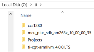

  • Hi
    Took the project, installed everything on a brand new machine (no prior TI kits installed).
    The devboard is the official LP-AM263, not your CC board. This might matter.
    [Cortex_R5_0] ASSERT: 0.734s: mmcsd/v1/mmcsd_v1.c:MMCSD_open:254: status == SystemP_SUCCESS failed !!!

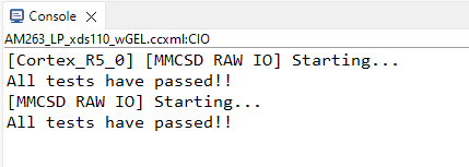

  • Hi Barna,
    I just try the MMCSD RAW IO in SDK10 on AM263LP, it works on R5FSS0-0.
    1. 16GB SD card
    2. Bootmode is DevBoot, SW1[4:1]=b0100
    3. AM263x GEL is used
    4. SDK: 10.0.0.35
    5: CCS: 12.8 with CLANG 4.0.0.LTS, without opening the sysconfig

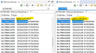

  • Hi
    The one on the left works, the one on the right does not (both works with SDK9).
    Same speed grade. Any idea what can be different between the two RAW MMCSD wise?
    Where can I change this clock?
    I just want to try a low-er speed - the old SDK9 had a direct number there what I could change, now is a selector what I do not know where is defined. Tried both versions but the CORE one I guess is even higher.

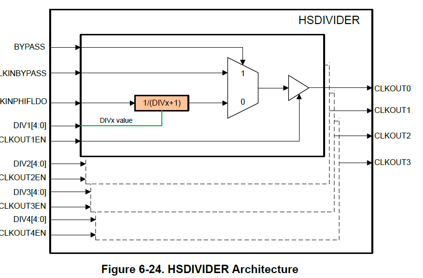

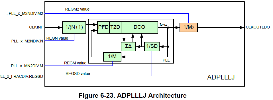

    If you use GEL files, you can modify the peripheral clocks by changing the dividers in hotmenu Program_Per_PLL() in AM263_PLL.gel file.
    PLL_PER_HSDIVIDER_CLKOUT1 is = OSC (25MHz) * M /[(N+1) * N2 * M2 * HSDIVDER]
    Where PLL = M * CLKINP / [(N+1) * M2],   In gel file, M=0x300, N=9, M2=1, and CLKINP=25MHz   --> CLKOUTLDO=1920MHz

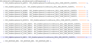

  • The PER_HSDIV0_CLKOUT1 can also be change by SysCOnfig generated function in ti_power_clock_config.c:
    That file is regenerated on every build, any change is deleted (since this file is autogenerated) so this will not work.
    And I think not the clock source should be modified but the individual clock per peripheral.
    For example we use a lot of peripherals in the same time and all of them use the same DDL_PER_HSDIV0 _CLOCKOUT0 (or CLOCKOUT1) like this:
    If I modify the clock source it will trash the rest of them using the same clocksource.
    I would need to modify that 192000000, not the SOC_RcmPeripheralClockSource_DPLL_PER_HSDIV0_CLKOUT1.
    Or CLKOUT1 is the same freq everywhere?
    If yes I start to wonder if gSocModulesClockFrequency is correct this way having more frequencies for the same CLKOUT1 - would that even work? Based on your drawing there is one CLKOUT1 not 3 like in this autogenerated SOC_ModuleClockFrequency array. Am I missing something?
