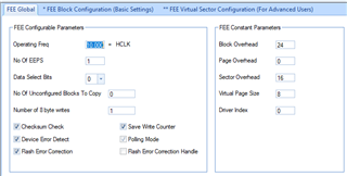

I am facing a weird issue with the emulated EEPROM. Whenever I set the block size larger than 8 bytes (like 16 or 32 bytes), the bytes at index 12,13 and 14 are always zero.
This is my printf() log:

CHAN:  0

This is my HALCoGen configuration:
I tried with disabling all ECC-related parameters, but the result is still the same.
