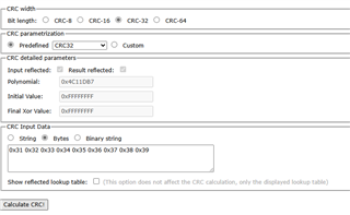

    so, Instead of this I Tested my own data to calculate the CRC like below
so, from this value i am getting some CRC value(i attached below)
but i couldn't able to find those values (Polynomial, Initial value, Final XOR, Inverted Input, Inverted Output),because without those values how they where calculating CRC?

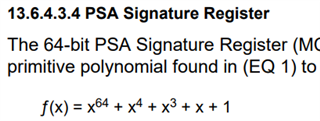

2.   I referred TRM in that i could able to find the polynomial for crc32
  but if you see that those polynomial are not in the hex. because my understanding is that we need
all the value required to CRC Sunshine's Homepage - Online CRC Calculator Javascript (sunshine2k.de)
My doupt is that what is the (Polynomial, Initial value, Final XOR, Inverted Input, Inverted Output)? used in the SDL_MCRC_FULL example?can you mention what are the value using for doing crc32 calculation.

    The CRC-64-ISO is used by MCRC on AM263x device. The polynomial is f(n) = X^64 + X^4 + X^3 + X^1 + 1
    The computation is performed by the MCRC hardware. Normally the initial value of CRC is 0xFF, and final XOR is 0x00. I don't know the inverted Input and output used in CRC computation.
    The CRC64 in Sunshine2k may use different polynomial from MCRC does.

    CRC32 and CRC64 use different polynomial formulas which generate different check values (or CRCs) for the same input data.
    At start up, the CRC algorithm sets the CRC to the initial CRC value (0xFFFFFFFFFFFFFFFF) XOR the input data (dividend). Once the CRC MSB is equal to 1, algorithm shifts CRC one bit to the left and XORs it with the polynomial. Otherwise, it only shifts the CRC one bit to the left. Repeat this process, the remainder is the CRC value or check value.
