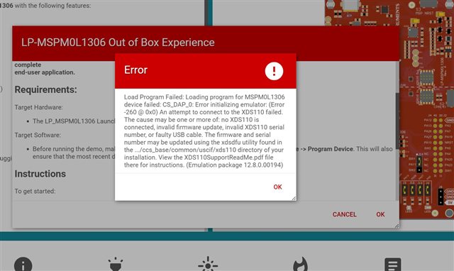

It failed miserably. While I tried to use the web based "out of box" it failed after using 3 different browsers. rebooted the whole 9 yards.
The board gets detected but then quickly disappears.

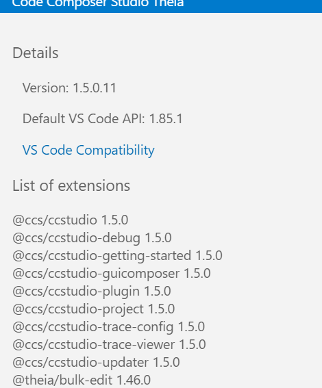

I try running Code Composer and it fails, says i need to update the firmware. why doesn't it do that within CCS?
I get a failure as you can see and it indicates I should go reflash the firmware. OK, I think that is horrible for a "out of box" to require that step but OK.

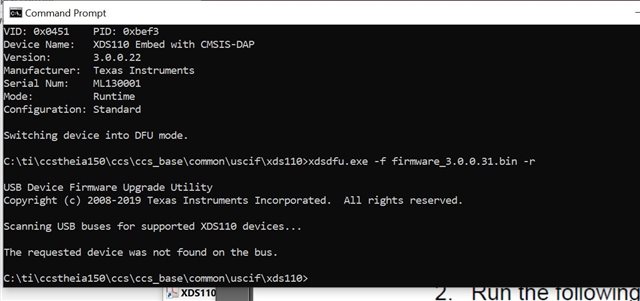

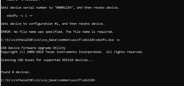

I run xdsdfu.exe with -e to enumerate the boards and its there, the board is detected. If I use -m the board is no longer seen and the flashing utility does not work.
I am using the provided USB cable and I have just taken the board out of the package it was sent in.
What are the next steps to resolve? Send me a new board?
