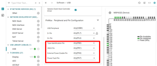

  • I am using these pins on UART interfaces.
    Could this be the cause of my problem?
    Can I disable them in the firmware of the USB example firmweare to use them on the UART interfaces?
     I don't understand what you mean to disable them in the firmware of the USB example. What is "them" that you want to disable? In general, you cannot use the same pin for two different functionalities (.e.g USB and UART at the same time) if that is what you mean to ask.
     Have you run the example as-is on the LaunchPad? Can you confirm if it is working or not?
     I'm not familiar with TUSB2046B to comment if your connections to it is correct or not. Are you connecting a mouse to one of the USB ports on TUSB2046B?
     Have you tried to connect a mouse directly to MSP432E USB host port on your board bypassing  TUSB2046B  and run the usbhostmouse_MSP_EXP432E401Y example? This is one way to find out if there is an issue on your connections to TUSB2046B.
  • Hi Charles, Thanks very much for your reply.
    I am referring to PB0, PB1, PA6, PA7.
    PB0, PB1, PA6, PA7 on my board I use them for UART interfaces so I can use them on the USB.
    So I need to disable the use of Type Identification Pin, VBUS pin, External power enable pin, Power fault pin. Is this possible?
    I can't test the mouse directly to the MSP432 because I have it connected to the TUSB2046B on the board. As you see in the attached schematic DP0 and DM0 is the USB connection between the MSP432 and the TUSB2046B. The connection from the TUSB2046B to the mouse is through DP1, DM1.
  • PB0, PB1, PA6, PA7 on my board I use them for UART interfaces so I can use them on the USB.
    Have you tried to keep these pins for USB and disable UARTs? Without the UART, does the USB host mouse example work?
