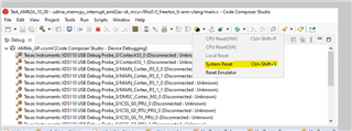

When I try to debug Reset_Isolation edxample project, I am getting the error which is you are going to see in the picture. And twhen I ignore and continue, application does not work properly.
[MAIN_Cortex_R5_0_0] [Error] Sciclient event config failed!!!
ASSERT: 0.2263s: syscfg/ti_drivers_config.c:Sciclient_gpioIrqSet:118: FALSE failed !!!
It fixed only when I pressed SW2 before debug but this is not something I want to do.
Any assumption/recommendation???
