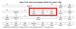

1- Isn't there a corresponding bit in the registers for using IF1/IF2 bits with DMA in the reference document I gave in the attachment? What kind of behavior occurs when I set them?

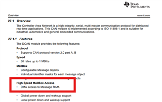

2- Also, what should I understand from the expression "High Speed ​​Mailbox Access - DMA Access to Message RAM" given in the attachment?

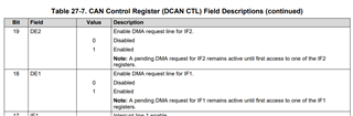

4- If data transmission is not performed, what is the purpose of "DE1/DE2 bits in the CAN Controller Register"?
5- What is the use of "DMA Activate" on the IF1/IF2 CMD register?

  • the DCAN1 IF1 DMA request is triggered if it is enabled by the DE1 bit in the DCAN CTL register, additionally in the DCAN IF1CMD register the DMA Active bit needs to be set. Then the transfer from/to IF1 and message RAM needs to be triggered. Once the transfer completes the DMA request will be triggered.
    The transfer between DCAN1 IF1 and Message RAM should be triggered manually by writing the message number to IF1CMD register.
    No, the message RAM can not be accessed by CPU and DMA in normal operating mode.
    But can be accessed by CPU and DMA directly in test mode.
    It is to enable the DMA request after the transfer between IFx and Message RAM completes.
