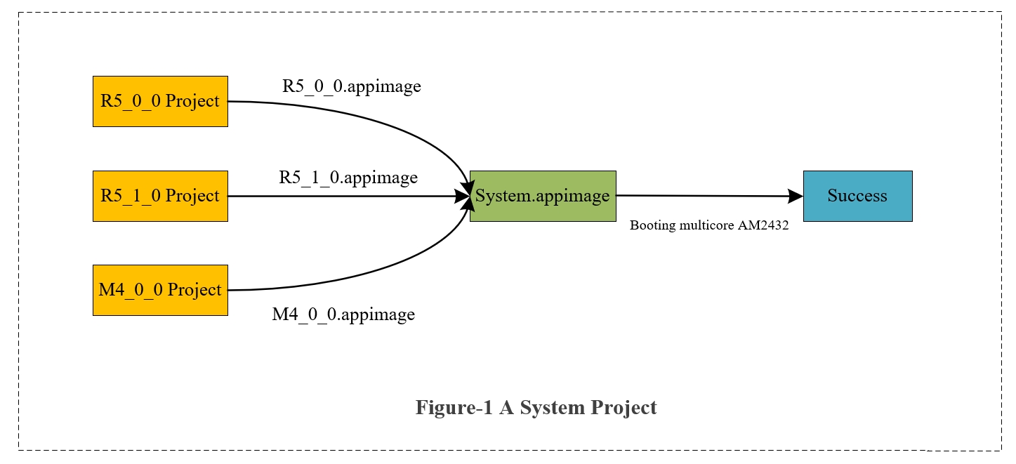

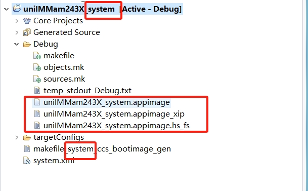

    (1) Figure 1 gives a brief introduction to the system project provided by TI.
    In Figure 1, a system project can combine the “R5_0_0.appimage”, “R5_1_0.appimage” and “M4_0_0.appimage” application files into a "system.appimage" file. So we can use the “system.appimage” file to boot AM2432 normally. For example, in the SD card boot mode, put the contents of the “sbl_sd_am243x.tiimage” and “system.appimage” files into the "tiboot3.bin" and "app" files on the SD card respectively. After reconnecting the power, R5_0_0, R5_1_0 and M4_0_0 in AM2432 can boot normally.

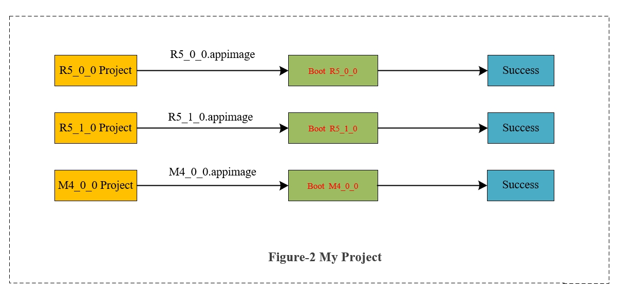

    (2) Figure 2 shows my actual needs.
    In Figure 2, I want to boot R5_0_0, R5_1_0 and M4_0_0 in AM2432 without using the system project by loading the “R5_0_0.appimage”, “R5_1_0.appimage” and “M4_0_0.appimage” application files. For example, in the SD card boot mode, put the content of the “sbl_sd_am243x.tiimage” file into the "tiboot3.bin" file on the SD card. Then access the "R5_0_0.appimage", "R5_1_0.appimage" and "M4_0_0.appimage" files on the SD card to boot the corresponding CPUs. To achieve this need, could you provide some technical guidance?

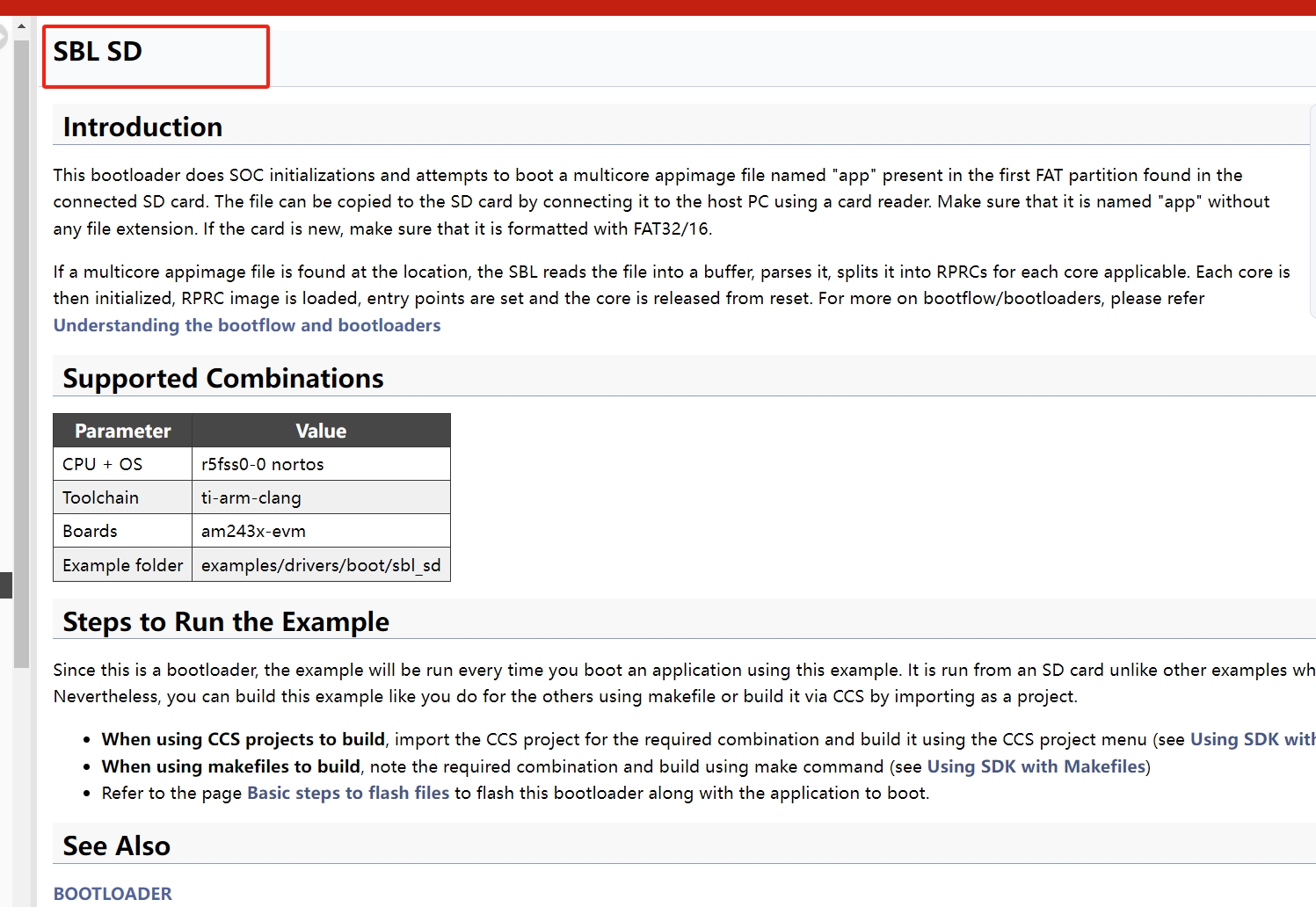

    (3) To achieve the need in Figure 2, it might be necessary to modify the sbl_sd_am243x program code.
    Because the sbl_sd_am243x_evm project can only access the app file on the SD card separately, and can't access three files. I don't know if my research idea is correct. If there's something wrong, I hope you can point it out. Thank you very much.

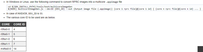

    The other option is create a multicore appimage with the existing *rprc files for each core.
    Please refer Multicore-appimage-gen to generate multicore appimages.
    You will need RPRC files for R5F00, R5F01, and M4F00 core.
    Please refer below image.
    Tushar
