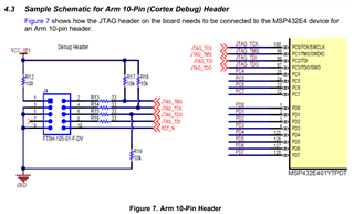

  • Refer to the recommended Arm-10pin JTAG header design in this app note. If you tie RST_N to ground then you are putting the device in reset. You should add a pullup to RST_N pin if you don't plan to use it.
    https://www.ti.com/lit/pdf/slaa777
  • If you tie RST_N to ground then you are putting the device in reset. You should add a pullup to RST_N pin if you don't plan to use it.
    I have pull up resister at RST_N node.
    Since as per the sequence of unlock procedure, the first thing to do is "Assert and hold the reset while powering of the device".
    To meet this, i'm using the jumper to short RST_N to GND. Later for the second part inorder to release the reset, i'm removing the short.
  • Your pin 9 on the Arm 10pin header is tied to GND?
    Ha, 9th  pin is connected to ground in my schematic as shown below.
