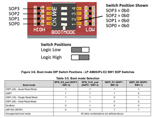

Hi Team,
1. TMDSCNCD263P support QSPI 4S/1S boot mode on AM263Px Control Card Evaluation Module User's Guide, but LP-AM263Px haven't QSPI 1S/4S boot mode information on AM263Px LaunchPad User Guide. Therefore, LP-AM263Px support QSPI 4S/1S mode?
2. I modified OSPI protocol to 1s-1s-1s in ospi_flash_dma example base on SFDP, but the result is an fail. Do I need to modify other configurations?
