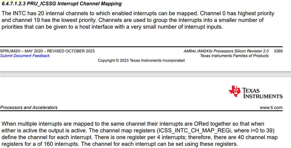

  • Matsumoto-san,
    The priority of interrupts these interrupts is determined by the hardware. Lower interrupt numbers have higher priority.
    Searching in "single_chip_servo.c" I found the following:
    ch1: hwiPrms.intNum      = ICSSG_PRU_ENDAT_INT_NUM; which correspond to "CSLR_R5FSS0_CORE0_INTR_PRU_ICSSG0_PR1_HOST_INTR_PEND_0 (120U)"
    And ch2: hwiPrms.intNum      = ICSSG_PRU_ENDAT_INT_NUM + 2; which correspond to "CSLR_R5FSS0_CORE0_INTR_PRU_ICSSG0_PR1_HOST_INTR_PEND_2 (122U)"
    From AM243x TRM I see there are two prioritization levels. Channel number and Interrupt number. For both criteria "pruEncoderIrqHandler" should have the higher priority
    thank you,
    Paula

  • Matsumoto-san, one of our experts sent below information.
    There are three ways to do this:
    1) we can generate same event number for both the axis
    2) we can use different event number for both the axis and map it to same INTC channel (Here lowest INTC event number is given high priority
    once, high event is served, lowest priority one should be served again)
    3) we can use different event number for both axis and different INTC channel and same host Interrupt (Here lowest INTC channel number is given high priority)
    In order to implement 3rd case we can do the following in "tisddf_pruss_intc_mapping.h".
    These are the event numbers, channel number, host Interrupt number used by both the axis, after making the changes :
    event_18 -> channel2 - > host Interrupt2 -> 120 (R5F0_0)
    event_20 -> channel4 -> host Interrupt2 -> 120 (R5F0_0)
    Also, please update application's EnDAT to use "hwiPrms.intNum" 120 for both Motors
    Please let us know if this works for your customer's use case
