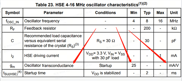

The clock of AM2432 is realized by passive crystal. At present, we need to calculate the oscillation gain margin of the crystal. We need the gm (transconductance) parameter of AM2432, but it is not reflected in the chip manual. Can you provide this? Thanks.
Here is the example from NXP STM32:
