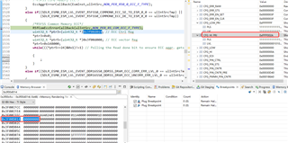

  • Hi Potturu
    Here is the English translation based on your requirements:
    I followed the guidance provided in the post and performed a DCache fault injection test, uncovering these issues:
    1、During the injection process, writing 0x28 to address 0x3f00d014 was ineffective.
    2、Upon completion of execution, an ESM interrupt is triggered but fails to exit; it instead loops in this location, comparing register values as follows.
    3、In an attempt to correct this issue by writing 0 to the location after entering the interrupt program via address 0x3f00d014, I found that these writes were still ineffective. Moreover, I did not locate register 0x3f00d014 in the AM2432's TRM .
    Please help me understand what might be causing these issues.
    Jimmy

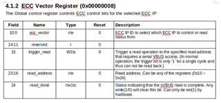

    You have to use the below code for clearing the 0x14 offset register
    // Add the below code inside the ISR/Abort Handler whenever an ECC error is detected
    // if error == R5F Cache ECC Error {
        uint32_t *ptr3=(uint32_t *)0x3f00d014; // ECC Ctrl Reg
        *ptr3=0x0;
        uint32_t *ptr5=(uint32_t *)0x3f00d008; // ECC vector Reg
        *ptr5=0x148000;
        while(((*ptr5>>24)&0x1)!=1) // Polling the Read done bit to ensure ECC aggr. gets properly updated
    You will be able to come out of the ISR only after the 0x3f00d014 register gets set to 0. This will stop the error injection.
    0x3f00d000 is the base address of Wkup R5 ECC Aggr.
    You can find the description 0x14 and 0x8 registers offsets below :
    Nihar Potturu.
  • Hi Potturu
    I cleared the value at address 0x3f00d014 in the interrupt handler, now it is 0, but I am still entering the interrupt handler continuously.
    When ESM0_CFG:CFG_HI_PRI's LVL is not set to 0xFFFF, it becomes impossible to exit the ESM processing routine.
    In addition, if it's not an injected DCache fault, would normal faults require clearing the 0x3f00d014 register? Normally, such events trigger only once.
    Please help me.
    Jimmy
  • Hello Jimmy,
    Normally, it will not be required to clear the 0x3f00d014 register.
    Can you try making your example run from non-cached memory and only put the 32KB arrays "a" and "b" in cached DDR/MSRAM.
    Nihar Potturu.
