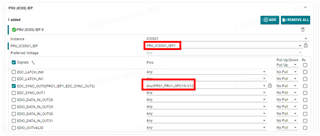

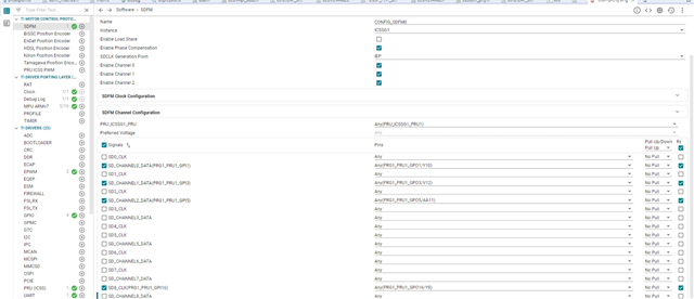

I am trying to use SDDF based on single_chip_servo_am243x-lp_r5fss0-0_nortos of motor control SDK.
In the example, the SDDF is ICSSG0 and PRU0. And on my board it is ICSSG1 PRU1, the chip is AM2431-ALV.
So the issue is that gSddfChSamps stays 0 and rtuSddfIrqHandler is never triggered after the initialization.
The modification is as follows,
1. mclk_iep_sync.c

In this file all CSL_PRU_ICSSG0_IPE0_BASE is changed to CSL_PRU_ICSSG1_IEP1_BASE.
    //  Set SYNC0/1 high pulse time in iep clok cycles  ( 7 clocks for 20 MHz at 300 MHz iep clk)
        //HW_WR_REG32(USED_IEP_BASE+CSL_ICSS_G_PR1_IEP0_SLV_SYNC_PWIDTH_REG, 0x0006);
        //  Set SYNC0/1 high pulse time in iep clok cycles  ( 5 clocks for 20 MHz at 200 MHz iep clk)
        HW_WR_REG32(USED_IEP_BASE+CSL_ICSS_G_PR1_IEP0_SLV_SYNC_PWIDTH_REG, 0x0004);
    //  Set SYNC0/1 period  ( 15 clocks for 20 MHz at 300 MHz iep clk)
        //HW_WR_REG32(USED_IEP_BASE+CSL_ICSS_G_PR1_IEP0_SLV_SYNC0_PERIOD_REG, 14);
        //  Set SYNC0/1 period  ( 10 clocks for 20 MHz at 300 MHz iep clk)
        HW_WR_REG32(USED_IEP_BASE+CSL_ICSS_G_PR1_IEP0_SLV_SYNC0_PERIOD_REG, 9);
Clock is also updated because the base clock and IEP clock is changed to 200Mhz. PRG1_PRU1_PGI16(V12) can successfully output 20Mhz clock.

  • Oh, the SD clock is configured at PRG1_PRU1_IEP1 PRG1_PRU1_GPO19/V19. It only output 20Mhz when IEP1 is configured.
  • So today I also tried to use SDFM based on icss_sdfm_three_channel_with_phase_compensation. ICSSG1_PRU1 is used this time. When the core is halted, it is also stuck in wait_loop.
  • It waits to get IEP0 cmp4 event hit so can you check IEP0 register. You need to check following registers
    • IEP_CMP_CFG_REG, Bit 5th should be set
    • IEP_CMP_STATUS_REG, When CMP4 get hit, bit 4th should get set
    • IEP_CMP4_REG0, This register should not be zero
    Also Check following things
    • PIN muxing for ICSSG1 PRU1 SDFM in sysconfig
    • R5F interrupt settings for ICSSG1
    • Selecting correct ICSSG1 Slice Id
    Here we have only V and W, so channel 0 and SD_CHANNEL0_DATA are not slected.
    The rest is same

  • Hi Achala,
    I have measured PRG1_PRU1_GPO19. There is no clok output when initSdfmFw uses IEP0. It appears that the CLK is valid if I use IEP1.
    How do I map this pin to IEP0?

  • No, I have measured the pin, the clock is only out when IEP1 is also configured.
    So in sysconfig, the PRU IEP section, V12 appears to be mapped to IEP1.
    When IEP0 is selected, V12 turns to grey and is not selectable.
    From your argument I believe V12 can also be mapped to IEP0. But there is just no clock. Yesterdays project I have to first run IEP1 code, then IEP0 code, and get SD_Clock.
  • From your argument I believe V12 can also be mapped to IEP0
    No, V12 is mapped with IEP1 sync out only!! To get clock on PRG1_PRU0_GPIO19 pin you need to select PRG1_PRU0_GPIO19/W7 for IEP0. Doing pin mux of IEP1 pins will not work for IEP0.
    BR,
    Achala Ram
  • When IEP0 is selected, V12 turns to grey and is not selectable.
    Yes, SYNC pins for IEP0 and IEP1 are different, It will not allow selecting same pin for both IEPs.
  • OK, so currently our hardware design is that PRG1_PRU1_GPIO19 is used to output 20Mhz clock. So it seems I have to init both IEP0 and IEP1 to get the output.
    And it would be better for us to change it back to PRG1_PRU0_GPIO19 to use only IEP0, correct?
  • Yes, IEP1 to get clock on PRG1_PRU1_GPIO19 pin and IEP0 to get IEP0 CMP4 hit for SDFM sampling!!
    Yes, correct!!
