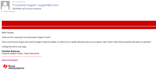

  • Hi Christian Espinoza,
    We had purchased the part from Authorised Distributor- Mouser Electronics.
    Yamuna
