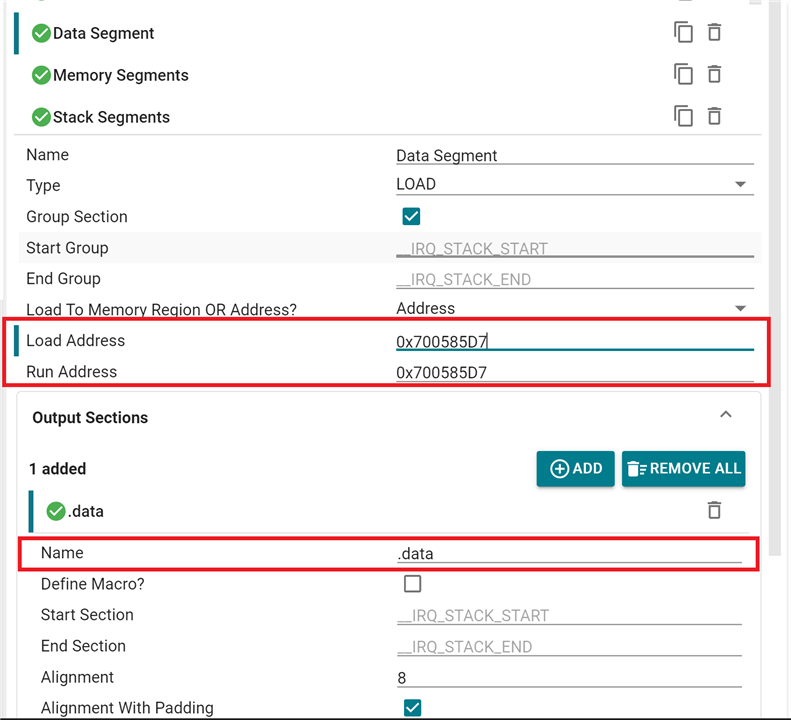

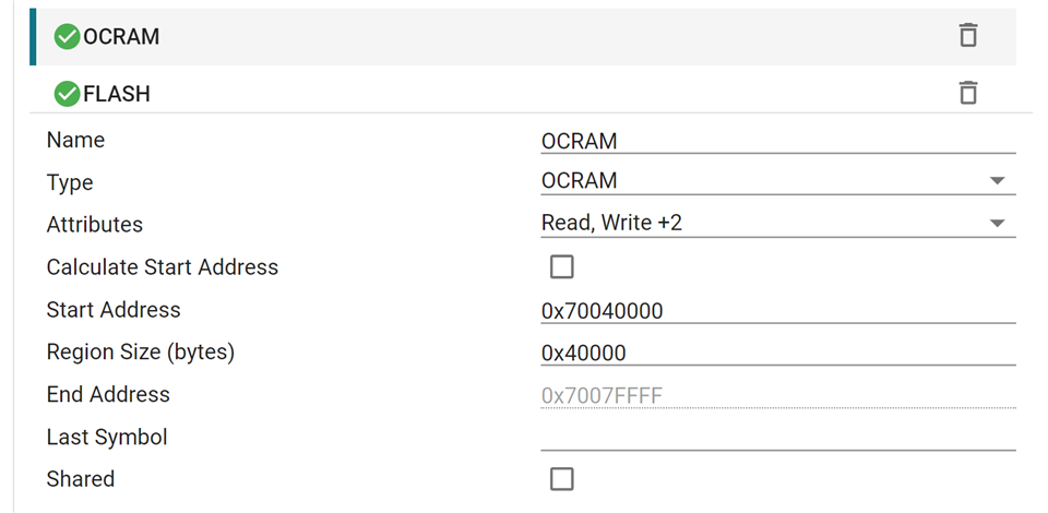

1.How to find the start address and End address of the program from the (.map) file actually what ever we build the program is storing in the RAM
so, i need to find the RAM start address and End address.. can you say for the below map file?

    Thank you for your replay and i have one more question,
    1. Actually when ever we built the program. The program is stored in between those 0x70040000 - 0x70080000 those memory we can't say before where it will start. so, i want to fix the address,
    so for example, if i built the code i want my program should load particular in this address (example : 0x700585D7).
    can you say what i need to do? where i need to configure?
  • Hi AK,
    The memory region 0x70040000 - 0x70080000 (length = 0x4000) is the OCRAM on AM263x.
    If you open the example.syscfg file of your example and go to the "memory configurator" section and you will see this same region defined here:
    The program has a lot of components (vector table, .text, .data etc), can you please specify what exact section do you want to be stored at 0x700585D7 (OCRAM).
    Now, if you want to fix the load address for a particular entity, let's say ".data" section, you will have to create a new and dedicated memory region for it.
    1. In Syscfg -> Memory configurator -> Section, Modify the load address (make sure the address is aligned, 0x700585D7 is not an aligned address.
    Then rebuild your application and you will find the .data section starting from the address you specified.
    Shaunak

    It is possible to do the exact opposite of what you want. In the same memory configurator section, you have an option to enter what you want to "fill" in this section. By default, it is 0. You can change it to 255 (0xFF). This will fill your complete .data section with 0xFF while initialization. Later when you actual ".data" section is populated while building the application, it will get overwritten based on the required size, and the rest of the ",data" will have 0xFF filled.
    Please try the above and let me know if it helps address your problem.
    Shaunak

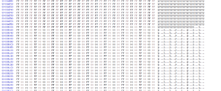

  • Hi Shaunak,
    I tried this logic from my side i got some area is Filled with FF and some of them are not Filled FF so i am attaching the .bin below
    if you see in some of the gab sections it filled of FF but in some sections it filled up of FF 00 00 00 FF 00 00 00 FF 00 00 00 FF 00 00 00 FF
    so u can see this problem in the above picture so can u say what is the thing i need to change?
    for your reference i attaching the .linker script below

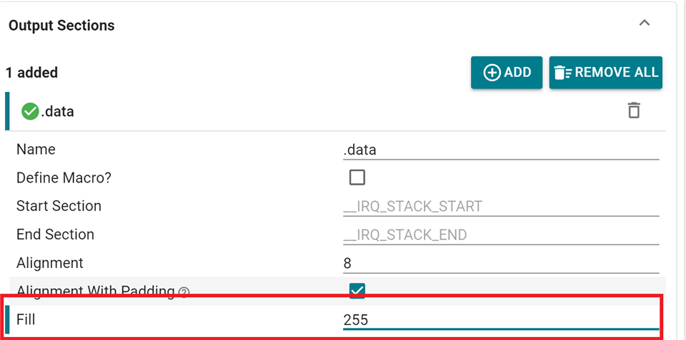

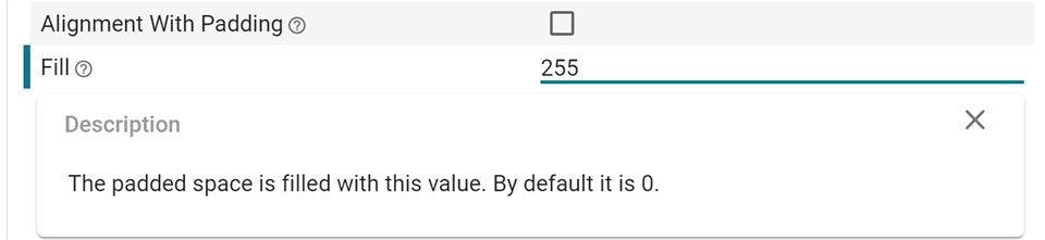

  • Hi AK,
    Can you please confirm if the regions that are not filled correctly are padded with Alignment or not? You can check your syscfg file. The "fill" works on addresses that are padded with Alignment.
    For example, if I disable the Alignment with Padding option, the fill won't work as expected.
    Also, can you help me understand Why do you need the complete memory region filled with 0xFF?
    Shaunak
