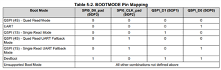

Part Number: AM2634-Q1
This post advises to use SOP3:0 = 1001 for boundary scan testing. However, this mode is not listed in the TRM. Could you please confirm the proper SOP3:0 setting?
François.
Hello Francois,
Thanks for raising this question and citing this prior post. This is actually an open topic with the team right now on which SOP modes specifically are needed to support Boundary Scan. I will take that post you've linked back as part of the discussion to try and get a closure on this.
