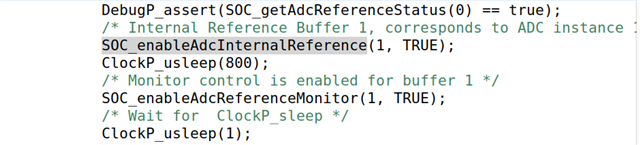

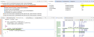

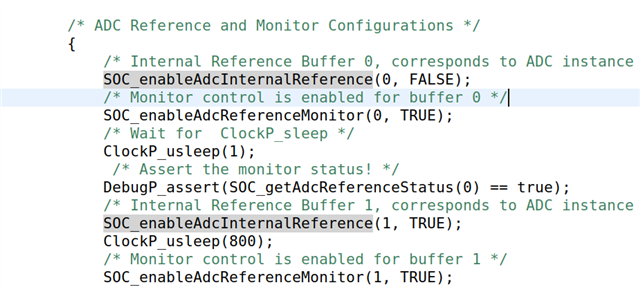

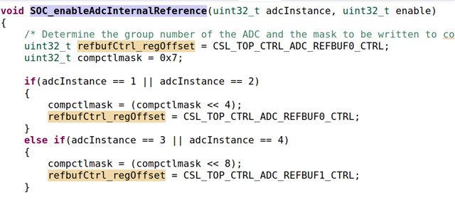

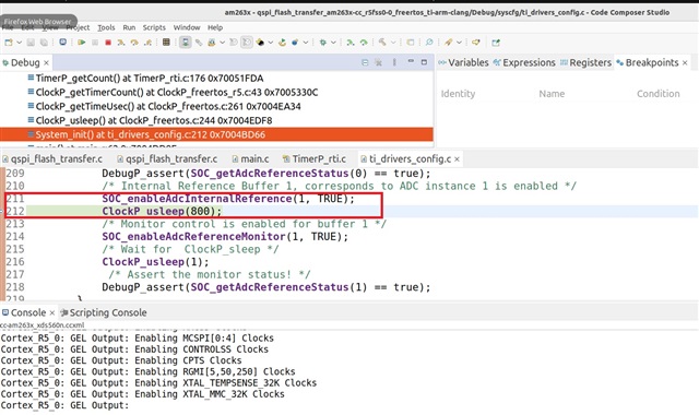

  I aways get fail during System_init(). To be more specific, you can see the traces by CCStudio, the program always get stuck after it enable internal reference buffer for ADC3/4  SOC_enableAdcInternalReference(1, TRUE);

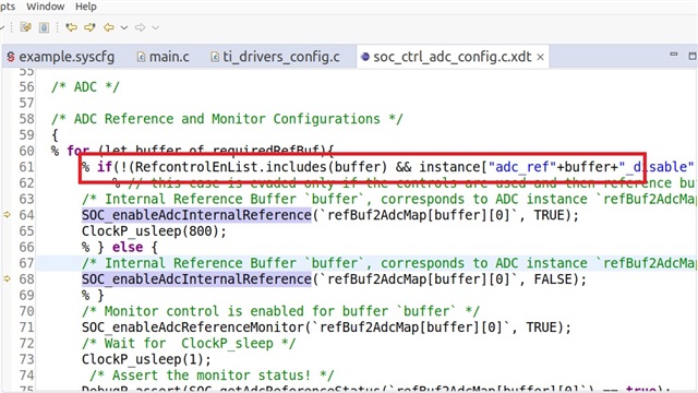

Question 1:

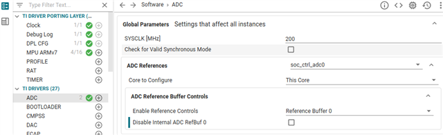

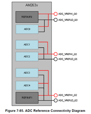

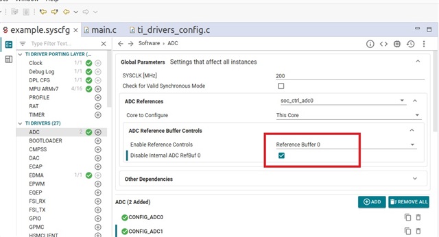

    Even I did not enable REF BUFFER1 in syscfg, the code auto generated by syscfg will still enable it if you have two more ADC converters. Why? The logic of template of  syscfg has issue. Reference Buffer 1 should only be enabled as ADC3 and ADC4 need it.  Please refer to block diagram captured from TRM.
Can I disable this buffer to save power If I don't want to use ADC3 or ADC4?  Did the template of syscfg has problem?

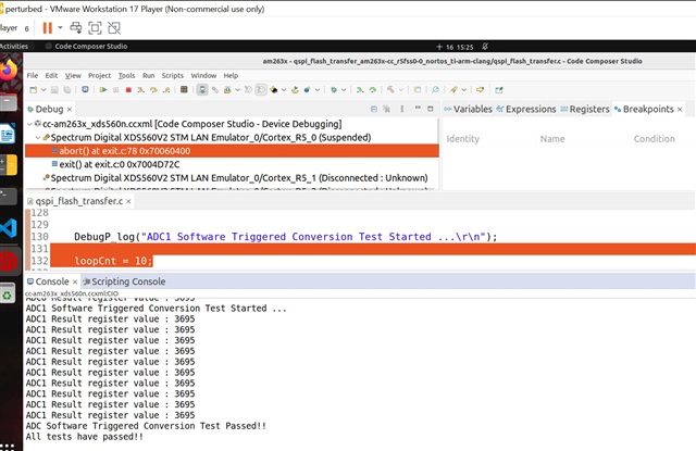

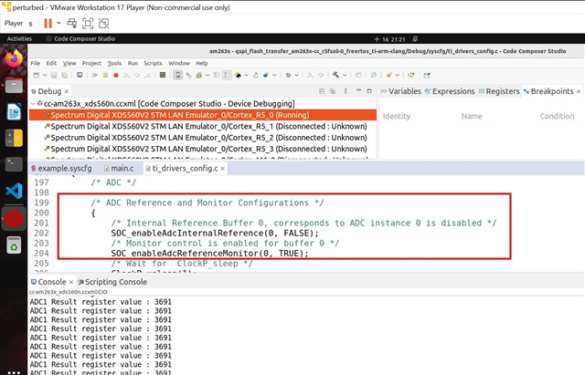

2. I did some more tests.  I use external Vref with above project by modifying syscfg as
The program can run successfully.
I also I tried to use noRTOS demo with both Internal Verf  and External Vref.
The results of both using internal and external Vref are good.  The test code as below.
qspi_flash_transfer_am263x-cc_r5fss0-0_nortos_ti-arm-clang.zip
The issue should not be caused by REFBUFF setting nor Vref source. I have no idea why 2 more ADCs using Internal Vref and FreeRTOS such combination makes issue in SDK10.0.0.35.
Can you please check this problem?
