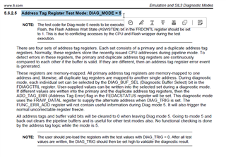

Additionally, I've noticed that in the SDL demo example, a certain test is commented out in the sys_startup.c file. Could someone explain why this test is commented?
Is there a specific reason or condition for it to be disabled by default?
#if 0
/* Run Address tag mode test on Flash */
retVal = SL_SelfTest_Flash(FLASH_ECC_ADDR_TAG_REG_MODE, TRUE, &failInfoFlash);
INCREMENT_PASS_FAIL_COUNTER(failInfoFlash, retVal);
#endif
