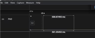

    Customer can try this demo below, this demo I just comments  the timer's interrupts in the main loop code(for the sysconfig I have not make any change, you can remove the timer if needed in the sysconfig).
    wwdt_window_mode_periodic_reset_LP_MSPM0L1306_nortos_ticlang.zip
    This demo can make the device reset by WTD every 500ms, you can see the PA0 is toggled every 500ms.And there is no any interrupt happen.

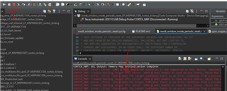

    By the way, this demo can't keep running at debug mode, because the WTD reset will interrupt the debug mode and make device disconnected as below. It is normal!
