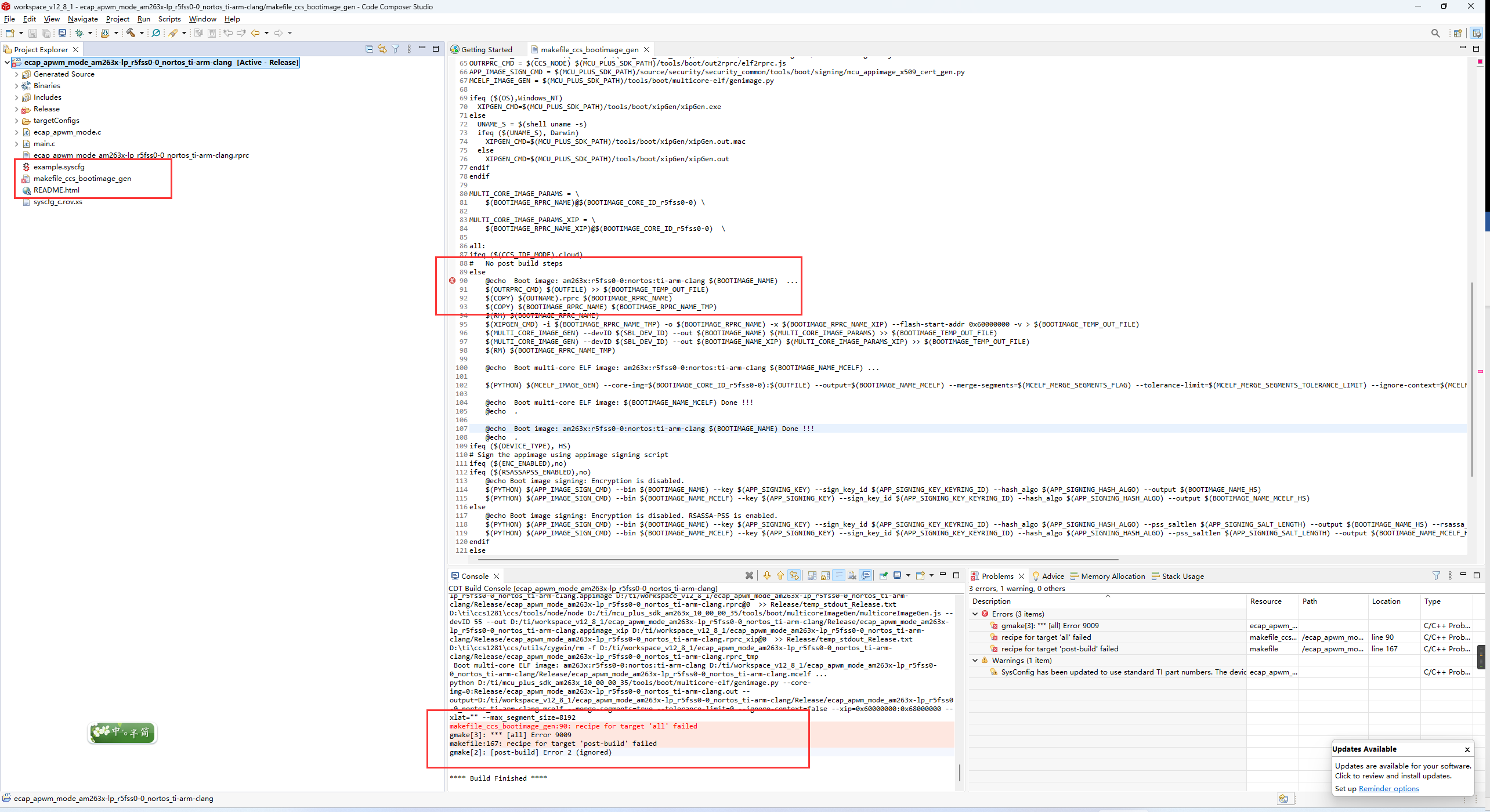

CCS Compiler error (v12.8.1)
Which MCU PLUS SDK version are you using?
Could you please see if by installing pyelf tools help here
pip install pyelftools construct:
AM263x MCU+ SDK: Achieving Fast Secure Boot and Boot time calculator
I installed the tool, but it still didn't fix the problem, and I went back to version 12.7
Could you please try the sdk setup instruction from fresh and follow this guide to do the same: AM263x MCU+ SDK: Getting Started
