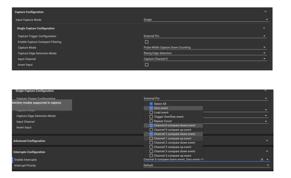

When using capture, is there any register/driverlib API to know if the input signal is kept in high or low?
For example, if the input PWM signal is 100% duty or 0% duty. How does MSPM0 capture it?
The user's setting like below.
  • What is there to capture? You would have to set up a time out in software and if you get no events in a certain time, assume it is CW.

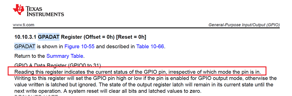

    Besides software method, is there any register to understand the current status of the pin directly?
    That is, a register for the status of the GPIO pin no matter the GPIO is used as an capture input, PWM output, an I2C SCL, SDA, a UART TX/RX?
  • Generally the GPIO peripheral (PF=1) is disconnected when the pin is assigned some other function (PF>1). So as you say the peripheral would need to provide a pin-state capability [analogous to CCI in the MSP430 timers]. I didn't find one in the Timer peripheral. Except for the I2C (MBMON register), I haven't seen that capability in any of the other peripherals.

    MSP430 and C2000 (called GPADAT) do have this register and can be useful in some cases including this post.
  • MSP430 and C2000 (called GPADAT)

  • Hi Gary,
    We understand capture is used based on edge detection, so the user wants a simple level detection method.
    The user is asking a register to get the status of the pin irrespective of the pinmux used.
    Like this C2000 register, GPADAT
  • Just to be clear: PWM measurement here needs two timer channels (in one timer module) -- one for each edge. They read from the same pin (ISEL bits), and you know which edge it is by which channel triggered. In an alternate universe [CCI/GPADAT], it would be possible to set a single channel to trigger on "both" edges, then read the pin to see which edge it was.
    The timeout is a separable thing. It can be convenient to use the (N+1)-th channel on the same timer (same time base) for a Compare using the expected time of the next leading edge. In this case, N=2, and (I think) none of the L13x series timers has more than 2 channels, so you'd need a second timer module to do the timeout. (A pin-read facility could be useful for this as well, though that could instead be managed in software.)
