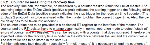

According to Heidenhain document (D1128897 - 03 - A - 02 8) - Safety with EnDat 2.2 and Non-Safe
EnDat Master
section 3.5.2 Counter for measuring the recovery time I
The recovery time can, for example, be measured by a counter realized within the EnDat master. The
last rising edge of the EnDat-Clock (positive signal) indicates the starting trigger and the following falling
edge of the EnDat-Data (positive signal) indicates the stop trigger for the recovery time I counter. (The
EnDat 2.2 protocol has to be analyzed within the master to obtain the correct trigger time. Also, the cable
delay has to be taken into account.)
The counter value has to be provided in a dedicated RT register at the interface of the master. The
counter and the RT register have to change dynamically in normal operation mode to detect “stuck-at”
errors of counter and RT register. This can be realized with a counter that does not reset. Therefore the
expected value for the recovery time is coded in the difference between the last and the current value.
The last value has to be stored in the safe CU.
For high efficiency fault detection (especially for multi-masters) it is necessary to load the counters of
different axes with different starting values. The difference has to be at least double the expected tolerance
range of the recovery time. Due to this and the incrementing values a forced dynamic sampling of
the counter is not necessary.
1) Section 3.5.2 specifies of a counter that does not reset as a means of RT implementation to meet "stuck at" detection requirement.
I can's seems to find "Non reset RT counter" in the endat interface.
Would you be  be able to provide "non reset RT counter" as part of endat interface
Thank you

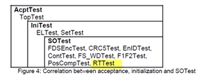

  • Our use case for RT is specified by section 3.3 of "Heidenhain document (D1128897 - 03 - A - 02 8) - Safety with EnDat 2.2 and Non-Safe EnDat Master"
    RT Test requirement is specified by section 4 of the same document
    Where RT Test needs to be performed as part of Safe Operation test
    Let me know if you need more information
    Alan I

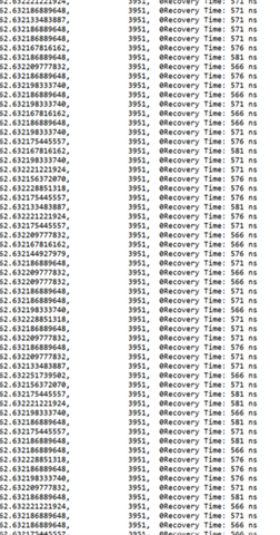

  • Hi Alan,
    I am getting RT for CMD 9 with your changes, but these values are in PRU cycle counts, not in nanoseconds, which is expected. The endat_command_process function performs the RT conversion, and endat_get_recovery_time returns the RT in nanoseconds. However, in periodic mode, this function is called only once, so the RT conversion does not happen after the first measurement, and endat_get_recovery_time returns the RT in PRU cycle counts.
    Thanks & Regards,
    Achala Ram
  • Hi Achala
    Thank you for trying out my modified version of endat_drv.c
    If I understand correctly , the last column  ( value 571) is cycle count , then value in ns is  571 * 1/300e6 * 1e9 = 1903 ns which matches short RT value of Endat Encoder  ~2us.
    May I know the IEP cycle and trigger points used for example above
    Thank you for your hep
    Alan I
  • Hi Alan,
    I tried several IEP Cycle  ie , 200000 , 400000 , trigger was set at 1000
    I used, 200000 for cycle count & 1000 for trigger point.
    PRU clock is set to 200MHz, so exact value will be 571*(1/200e6)= 2.8us.
    Thanks & Regards,
    Achala Ram

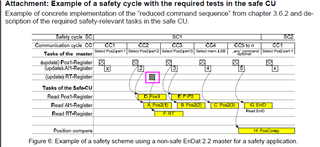

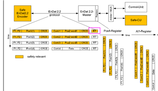

  • Hi Achala
    Thank you for Patch. I have run the patch using endat_diagnostic.c and RT looks much better than before.  I have one additional question regarding RT.
    Figure 6 from (D1128897 - 03 - A - 02 8) , shows that RT register is only updated once per safety cycle.
     Question : In order to match RT counter update rate as per figure 6,  Can I enable RT measurement only to specific MRS code during safety cycle
    Thank you
    Alan I
