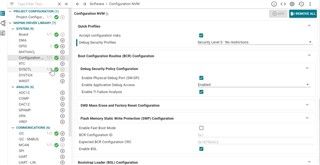

I'd like to configure generic security levels on MSPM0G3107 uC to Protection Level 1 with following customisation as highlighted:
This will be applied by hex modification from external tool.

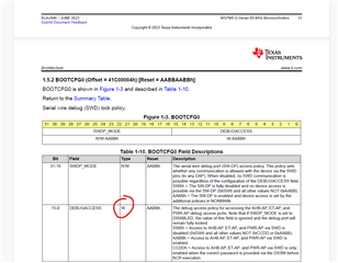

  2. To check App Debug Policy I would read BOOTCFG0 register field DEBUGACCESS but I cannot read this as in technical reference manual (SLAU846 rev.June2023) this bit is write only. How do I verify if correct app Debug Policy is set? Can I somehow read the setting? Or maybe its just a documentation issue and this register is indeed R/W?

Note ad.2: screenshot from SLAU846.pdf
