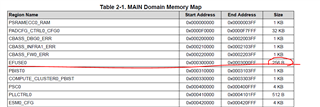

I want to confirm the OTP memory size in AM6421. EFUSE0 (256 bytes) is the OTP memory, right? Is there another OTP memory available in AM6421?
Please share the feedback.

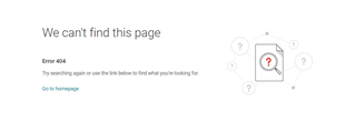

Secondly, I can not access the link you shared.
I am not sure what that EFUSE0 map is. There is only Secure & Extended OTP available. The Secure OTP is used for secure boot while Extended OTP bits are there for the customer usage.
And following is the correct link:
https://www.ti.com/drr/opn/AM64X-HS-RESTRICTED-SW
