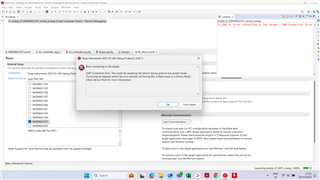

I am using the G3107 which is custom PCB with XDS110 debugger, Initially I am able to flash and debug it.
After couples of times of flashing I am not able to flash it. I tried various settings in CCS and even Uniflash and I always getting the same error -615 and sometimes
This is the complete log I get when pressing "Test connection":

and another error is like below
Please Provide the solution to resolve this asap. Thanks!

  • Initially I flashed I2C code which I was configured (sysconfig not used) then I got this error. From there onwards I am trying to flash G3107 Empty project only.
    Additional information,
    I am using XDS110 debugger of G3507 Launchpad to connect my target. I removed all the jumper pins(J101) of XDS debugger, and I connected debugger pins of GND, NRST, SWDIO, SWCLK to G3107 PCB. I am able to flash the same code using the same connections in other chip.

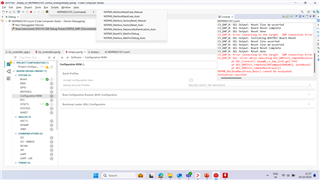

    Now I not able to execute the script commands as shown in the below image
    Could you please let us know how we can recover the PCB's after this error got triggered? And what are the reasons for this error?
    Would appreciate your quick support.
  • So if your I2C code changed the configuration of the SWD pins, meaning that the PINCM values of those pins were changed, this error makes sense to me. What you would need to do to recover the device would be to start by placing the device in BSL mode by holding PA18 high while you power the device on or reset it. Once this is done, the configuration of the SWD pins will be returned to the original state configured by your NONMAIN region. The device will remain in BSL mode for 10 seconds before going to sleep. So quickly after putting into BSL mode, issue a factory reset to the device using the scripts shown in your screenshot. This will erase the application code that incorrectly configures the SWD pins' PINCM values, which would allow you to access the device as normal again.
