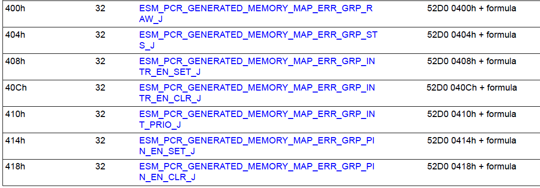

I am trying to enable all ECC and parity-check registers. Looking through the various examples in mcu_plus_sdk_am263x_10_00_00_35\examples\sdl\ecc, there is a ECC_Test_esmInitConfig_MAIN structure in ecc_trigger.c that I believe is enabling the interrupt for the specific ESM fault. The interrupts are enabled by setting bits at addresses 0x52D00428 and 0x52D0042C, yet the latest register addendum ESM register section (in spruj42e) only goes up to 0x52D00418 (in table 5-992). With the latest CCS 12.8 (using CLANG v3.2.2.LTS), my debugger view of registers also ends at this 0x52D00418. Where are the definitions of the registers at 0428 and 042C?

    Offset = Base + (j * 20h) for ESM_RAW_j
    J is the group number. Please refer to Table 10-22. ESM0 Interrupt Map in device TRM.
    Group 0: event 0 ~event 31,
    Group 1: event 32 ~ event 63,
    Group 2 is for pulse events (Table 10-23).
  • Thanks QJ, That 10-22 table is key. I am figuring out the many of the acronyms, but regarding the other question, where is the documentation for addresses 0x52D00428 and 0x52D0042C (written to by the example code), when table 5-992 only goes up to 0x52D00418?

    There are 3 ESM event groups (0, 1, 2), and there are 7 memory mapped error registers for each group: RAW, Status, interrupt enable, interrupt clear, interrupt priority, error pin enable and disable.
    The start address of group 0 is 0x52D0_0400
    The start address of group 1 is 0x52D0_0420
    The start address of group 2 is 0x52D0_0440
    The interrupt set register for ESM group 1 is at 0x52D0_0428                 --- 0x52D0_0408 + 1* 0x20
    The error pin enable register for ESM group 1 is at 0x52D0_0434           --- 0x52D0_0414 + 1* 0x20
