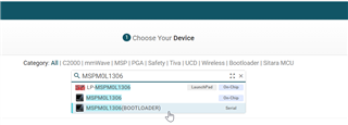

Part Number: MSPM0L1306
Does Uniflash also support new firmware download via UART?
Is there the guideline document?

Sorry I am afraid it does not support bsl to download new firmware.
Sorry for the mistake. I re-check it, and latest uniflash has supported BSL(Only UART via XDS110).
You can choose it at the new configuration.
After start, you can choose the COM Port and UART Baud rate.
