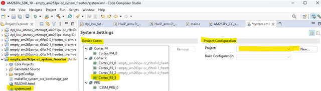

Are there any example projects that use all 4 cores with FreeRTOS ?
I've seen something similar in the empty project for the "MCU+ SDK for AM263x" but not a 4 core example for the "MCU+ SDK for AM263Px"
Alternatively, is the"MCU+ SDK for AM263x" usable for the LP-AM263P ?
