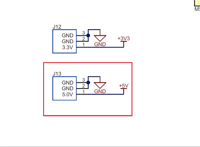

  • I really appreciate everyone's quick feedback on this topic.  Question, with the info shown below also work in powering up this circuit board, connecting 5Vdc to J13-1:       Do I still need to make jumper changes to JP1? and J101?  Thanks again for everyone's time and help.
  • You can certain apply the power there, but you should disconnect the jumpers on J101 to prevent back-powering the regulator.
  • So remove the 5V jumper on J101, correct, everything else stays the same
  • And 3.3. There is no 3.3 V regulator below J101, so you need to supply both 5 V and 3.3 V. (Check the schematic to make sure I am not lying to you.)
